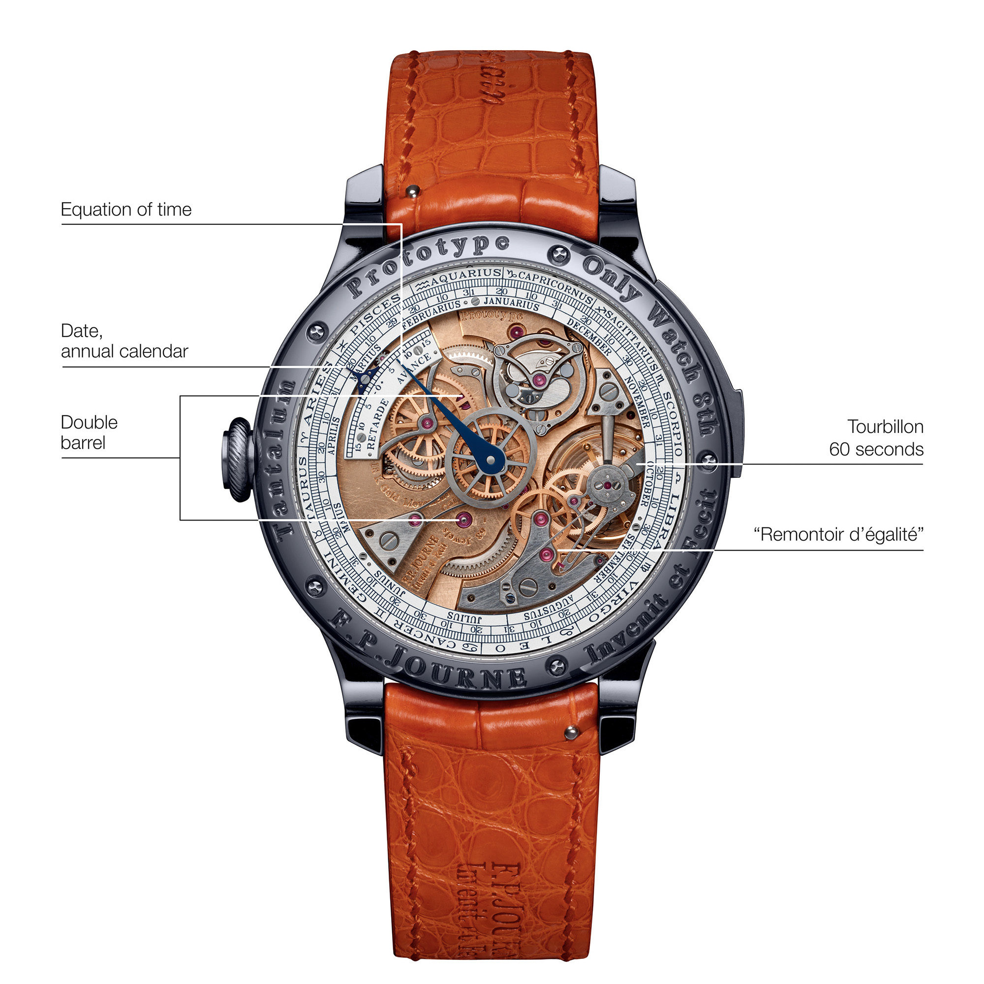

Only Watch, the biennial charitable watch auction, is here once more. F. P. Journe produced their exceptional Monopoussoir Rattrapante Bleu pièce unique for the last auction (see page 5). I loved that one so much that I felt it was only fair I write about their offering this year, which they call the "Astronomic Blue." The overall style is quite similar to the Monopoussoir Rattrapante Bleu, with the same bluish tantalum case and bright orange crocodile strap. The battery of complications, however, has expanded greatly.
It's hard to know where to start, so I'll simply go from bottom to top. At the very bottom is a power reserve indicator, flanked by the unusual seconds indicator and a moonphase disk very cleverly integrated into the design. The dial on the right holds two hour hands, allowing the watch to display two time zones. The minute hand corresponding to both hours is in the middle. The watch is also equipped with a minute repeater. The dial on the left displays 24 hour sidereal time. We also see a day/night indicator at the 12, which is one of my favorite features. The width of the indicator window is adjusted via the panels on the sides to account for the variation in the length of each day. Presumably it is fully open on the summer equinox and most closed on the winter equinox.
On the back we see an equation of time indicator, a rather bizarre calendar, the tourbillon, and a remontoir (I wrote about the remontoir on the first page, if you're not familiar).
I must say I prefer the uncluttered aesthetic of the previous watch, but the Astronomic Blue displays enormous technical knowhow and still manages to display it's huge variety of complications in an aesthetically pleasing style. In my opinion it looks much better than, for example, Patek's offering, a stainless version of their "Grandmaster Chime," although admittedly the Patek is even more complicated than this watch! Well done Mr. Journe!
